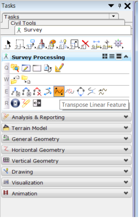

On creating an ascii file to create a terrain model, I have some linear features that needs to be reversed, can that be done in OpenRoads?
Answer:
Yes, this can very much be achieved in OpenRoads. Following are the steps to reverse the feature :
1. From the "Task Manager" select "Transpose Linear Feature" from "Survey Processing" category.
2. Locate the linear feature.
3. Give a data point to accept.
