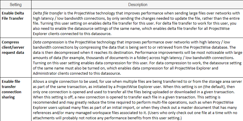

      Can enable (this is on by default) Delta File Transfer to only download the "changes" in the file vs the whole file.
      Can enable (Datasource setting) "Compress client\server request data"

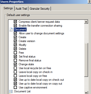

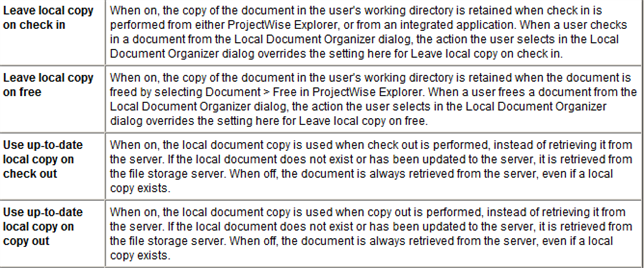

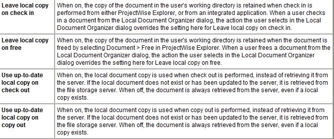

      Enable "Leave Up-to-Date" Local Copy on Checkin, Checkout, Free (See attached screen shot for different settings and descriptions of settings).

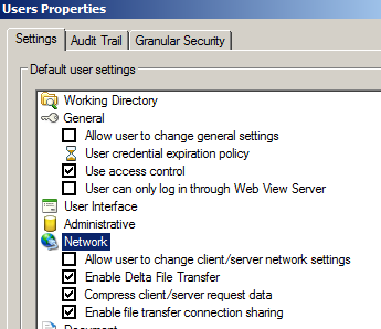

      Settings Descriptions below are in PW Admin module > Top Menu Help > Contents > Index Tab > User Settings > Network
The above and below settings have a Server setting in the PW Admin module > right click on Datasource > settings tab   and in addition, there is the PW Admin > Users node > right pane > highlight all users > right click > Properties > Settings tab
The below screen shot is from the PW Admin module > User Node > Right click on specific User in right pane > Properties > Settings tab > Document node
The description of the PW Admin > User settings is below (from the PW Admin “Help”)
