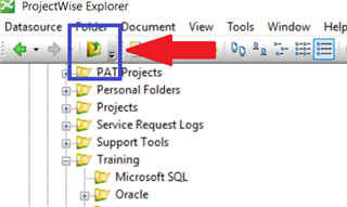

Opening the Local Document Organizer
The Local Document Organizer can be opened by clicking on the Organizer icon in ProjectWise Explorer:
