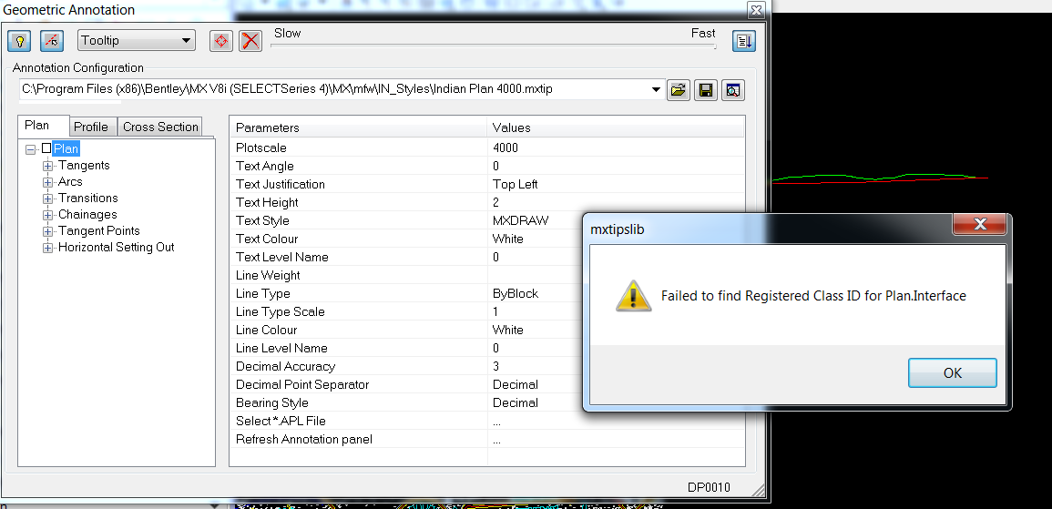

This Video demonstrates, how to resolved the error which occurs in MXRoad SS3 & Later version of MXRoad, when go to Draw > Annotate Drawings or Pages and annotating Plan, Profile or cross sections, it throws an error message " Failed to Find Registered Class ID". In this Video, I only edited the Plan.mxtip file, but this will apply to Profiles and Cross Sections as well.
