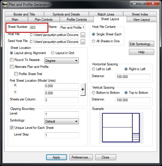

In Plan and Profile Generator, I would like to perform the following customization regarding my sheet numbers (CIV_SHEETNUMBER):
Answer:
You can specify the start value on the Sheet > Layout leaf of the Create Cross Section tool. It does respect leading zeros.
At this time, the product does not have the functionality to perform mathematical calculations.
