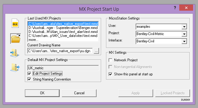

1. Start MX, and at the start up panel check mark the option "Edit Project Settings".

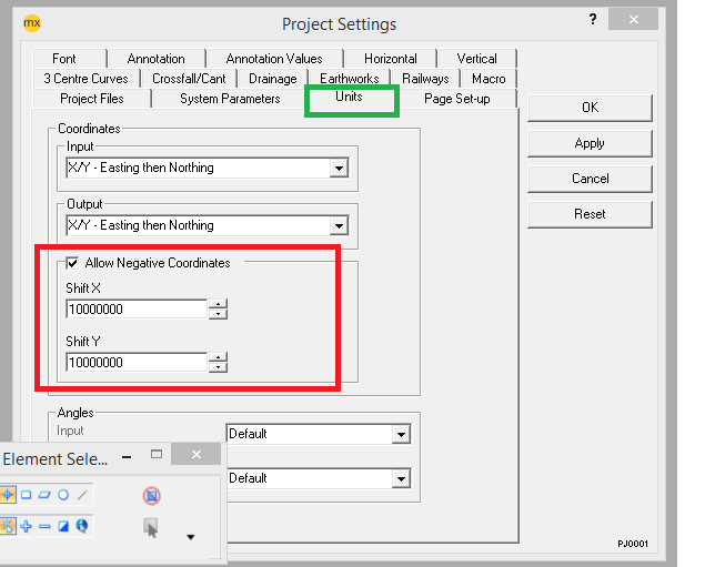

2. From the "Project Settings", select 'Units' and check mark the option "Allow Negative Co-ordinates", and give the highest value for 'Shift X' and 'Shift Y'.
3. Apply the changes.
4. Now, try to 'Export to Native' the alignment.
Make sure you have an active vertical profile for this alignment before you export to native.
