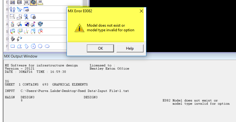

Error E0082 "Model does not exist or model type invalid for option"
Product(s):MXRoad
Version(s):MXRoad V8i
Environment: N/A
Area: Input Method
SubareaN/A
Original Author:Purva Lakde. Product Advantage Group
Problem Description: Run input file for Halgn and Valgn inside MXRoad, it throws error “Model does not exist or model type invalid for option”.
For testing: Please refer the attached Input file for your reference, to run input file go to MX menu File > Input > Select your input file and hit OK, you will see error.
Cause: When we run attached input file, there is no model name we have mentioned where we can create/save horizontal and vertical alignment.
Solution: Open attached input file, Enter/Create a new model name to run Halgn & Valgn, for example: CREA,DESIGN3, here we are giving command to MXRoad to create new model name “DESIGN3” so that we can store our Halgn and Valgn Data.
Please refer the corrected input file for your reference.
