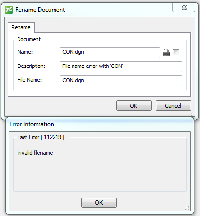

Error 112219 "Invalid filename"
(33637 False)
 Version(s):10.00.02.96
 Environment:N\A
 Area:Document Creation
 Subarea:Rename file
Trying to rename file to CON.doc and getting error:
How to avoid it:
Windows reserved names:
CON, PRN, AUX, NUL, COM1, COM2, COM3, COM4, COM5, COM6, COM7, COM8, COM9, LPT1, LPT2, LPT3, LPT4, LPT5, LPT6, LPT7, LPT8, and LPT9
Do not use these names.
Microsoft article about it: https://msdn.microsoft.com/en-us/library/windows/desktop/aa365247
