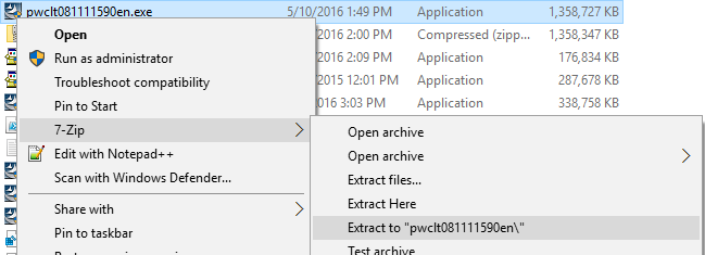

Option 3:  Unzip the package using a different extraction program (7-zip)
    1. Use 7-Zip to extract the pacakge which is a free extraction program you can download from the internet.
    2. Once 7-Zip is installed, right click on the Projectwise Client setups exe and choose  7-Zip, extract the files to a folder on your hard drive.
    3. Once the files are extracted, go to the folder you extracted the files to and run the setup.exe.  This should bring up a menu for you to choose which client program you wish to install.
