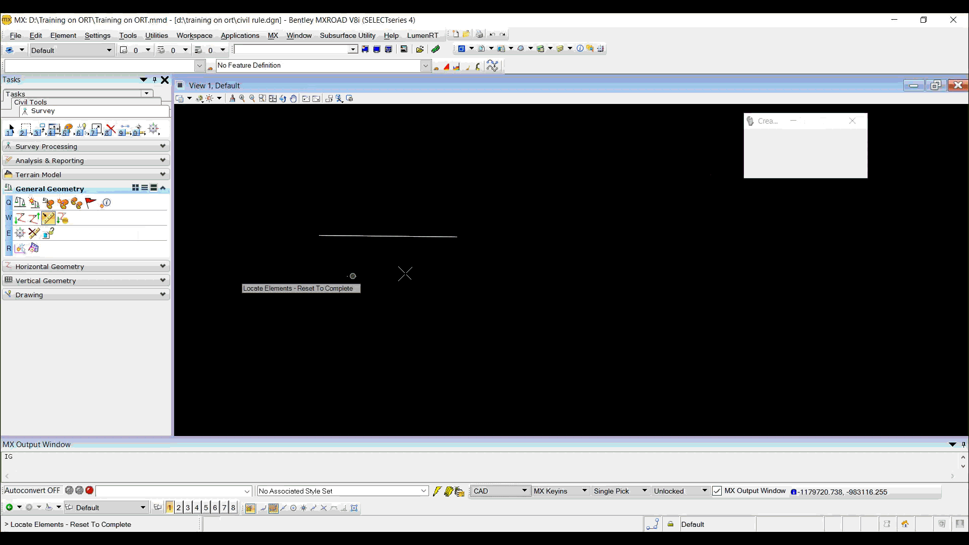

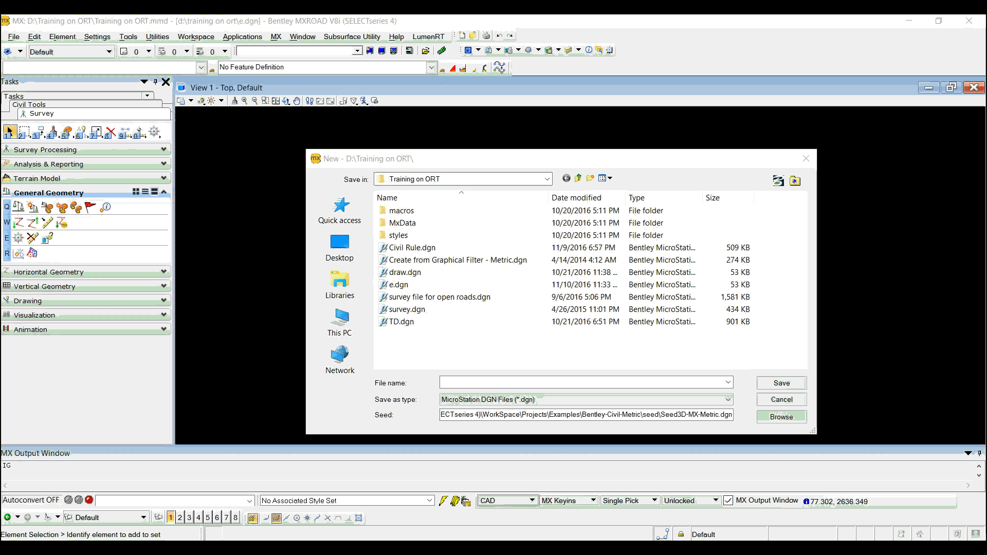

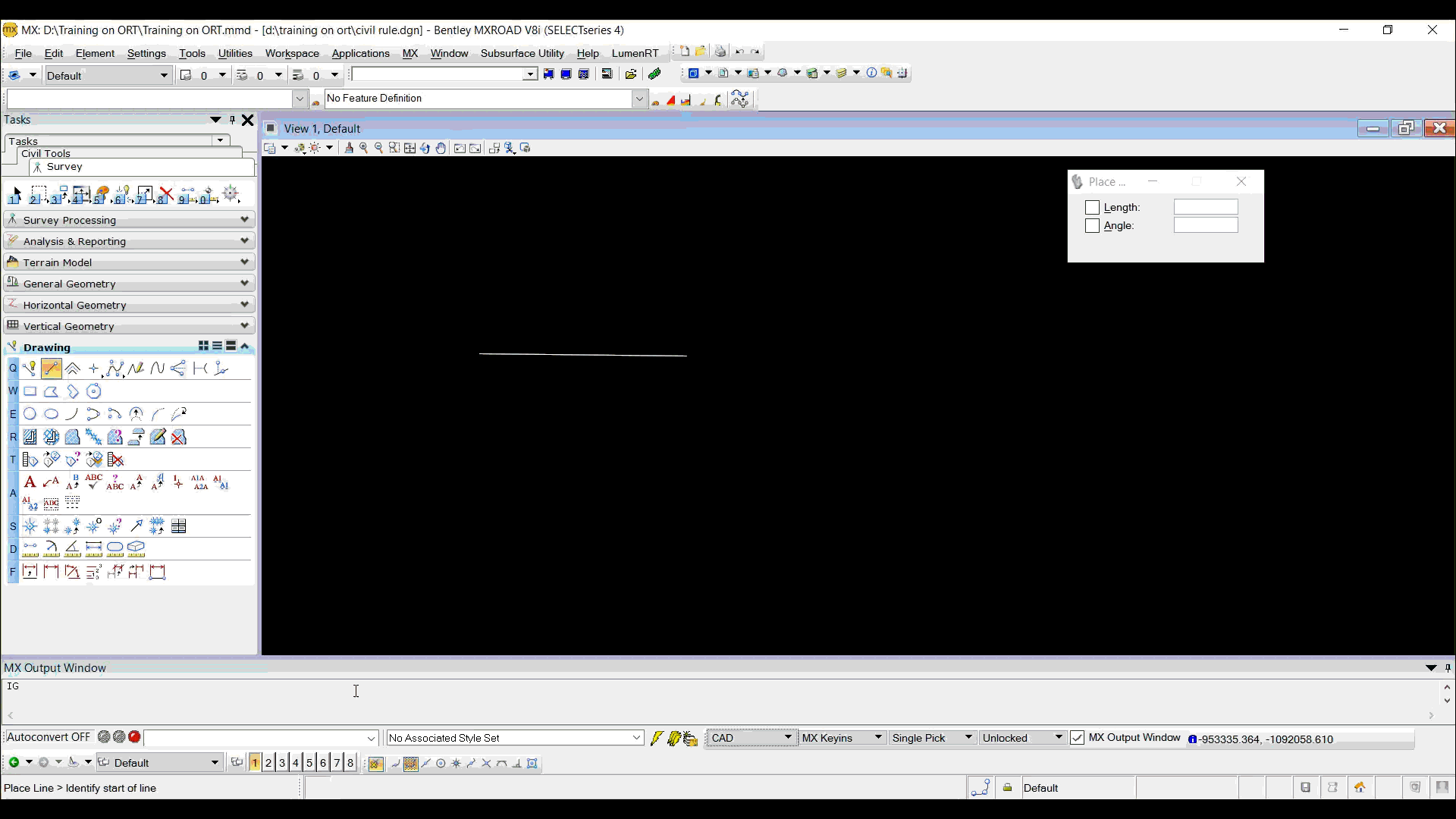

1. The element must be in a 2D design model to be able to convert it to a Civil Rule Feature.

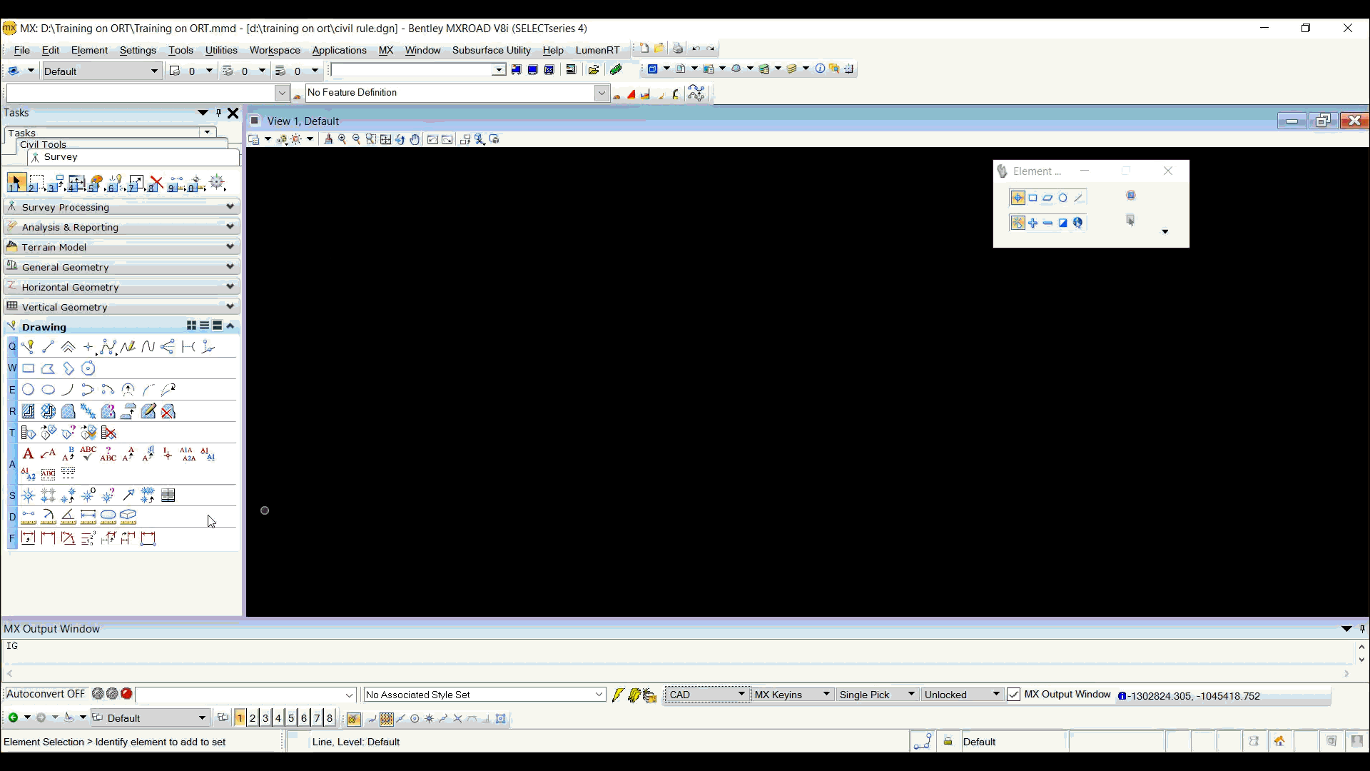

2. Draw a MicroStation simple Line as a example.

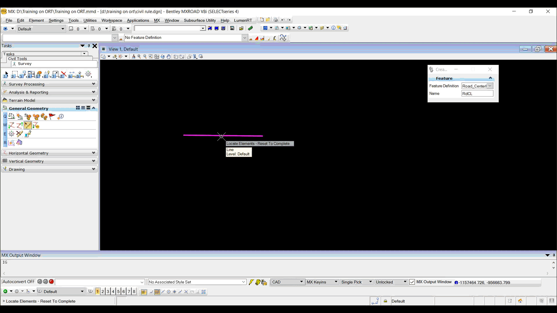

3. Open the Civil Tools task pane to the General Geometry section then click the Create Civil Rule Feature icon.
4. Select the graphic element to which you wish to assign rules and right-click to reset to close the selection set.
5.The selected element now has been assigned civil rules and you can select a manipulator to edit.
