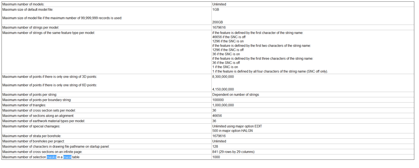

The below table gives the maximum values in MX, which includes maximum number of strings per model, maximum size of default model etc. Click the image below to view full size.
