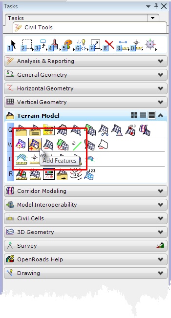

Can a linear template be merged into an existing terrain model?
Answer:
Yes, once the features are created using the linear template, you can use the Add Features tool to add them into an existing terrain model.
