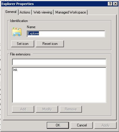

Verified Answer: RE: Shortcut from one ProjectWise folder to another? by Kevin van Haaren
Yes.  Create a new application that opens files with the .lnk (ell-nk) with Explorer.  Then drag the folder you want to make a shortcut to onto your desktop.  That creates an .lnk file. Drag that .lnk file back into projectwise in your Important Files folder. It's not perfect: if you don't make the files read-only they'll checkout to people. If you make files read-only (or set final status) then users get an annoying popup about the file opening read-only.  Click OK to jump to the folder anyway.

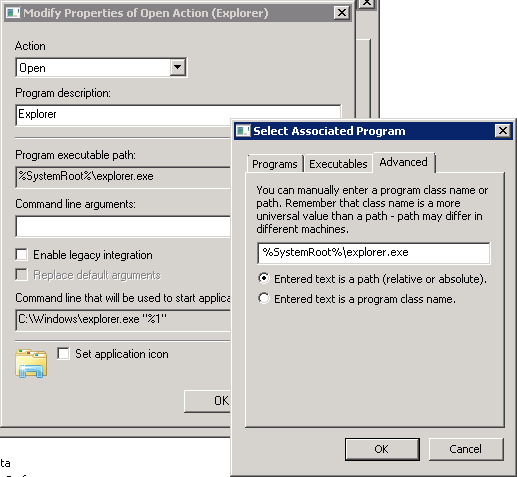

Question: RE: Shortcut from one ProjectWise folder to another? by Tom Felcone
Thanks Kevin - I got the Explorer Application created, but when I double click on my .lnk file PW asks what I to use to open the file.  If I browse out to explorer.exe the shortcut works fine.  What am I missing?
Question: RE: Shortcut from one ProjectWise folder to another? by Kevin van Haaren
Did you create the Open action in the Actions tab of the application properties?
