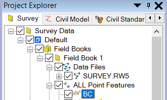

1.  Select the Point Feature within the Project Explorer.

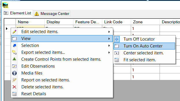

2.  Click Show Details within the Survey Processing tools in the Tasks window.
3.  Right click to the left of the Point Name, go to View > Turn On Auto Center.
Now when you select a point within this window it will zoom to the point.
