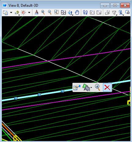

2.  Using the Element Selection tool, select the graphic element for the geometry and hover on the element.  There will be an HUD option to 'Delete' which will delete the element from the Design File.

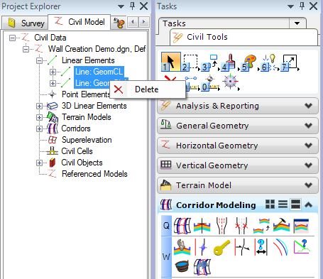

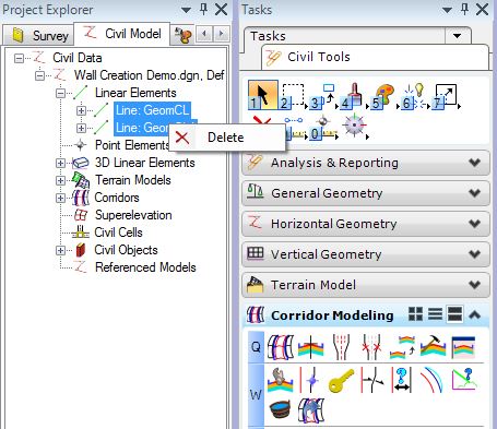

3.  Use the Project Explorer > Civil Model > Linear Elements to select one or more elements, right-click on the selection in the Project Explorer and 'Delete'.
