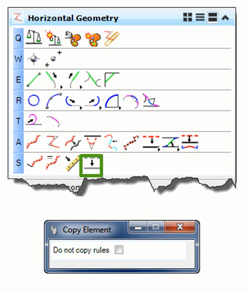

How do I create a copy of civil geometry? (SS4)
Version(s):08.11.09.722+
Area: General Geometry
Question:
Answer:
You will need to use the command Copy Element which is located in the Horizontal Geometry section of the Civil Tasks.
This will create a new geometry with the following properties:
If you toggle on "Do not copy rules", a new instance of geometry will be created with the following properties:
Note:  The MicroStation Copy tool will create an element that is not ruled, not featurized, not named, and not true civil geometry.
