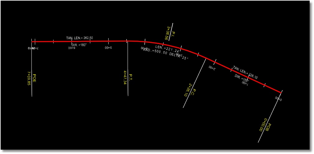

Question:
How do I reverse the direction of the horizontal geometry stationing?
Answer:

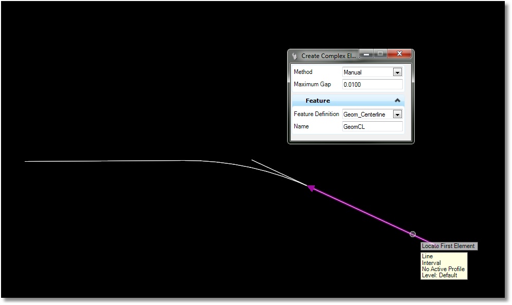

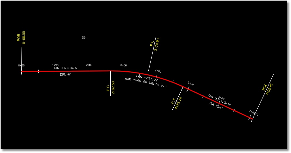

The station of the horizontal geometry element below is from west to east:

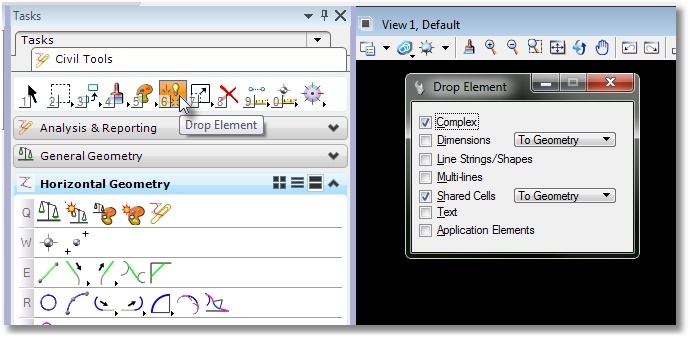

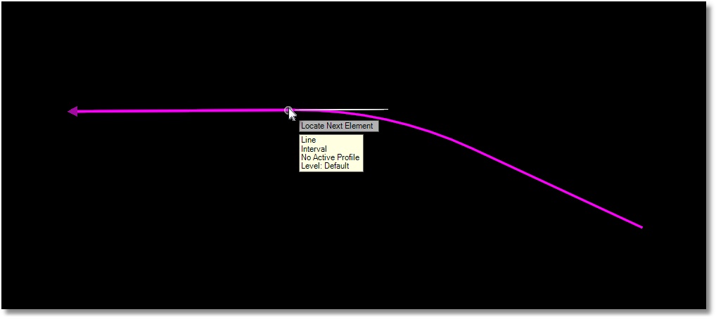

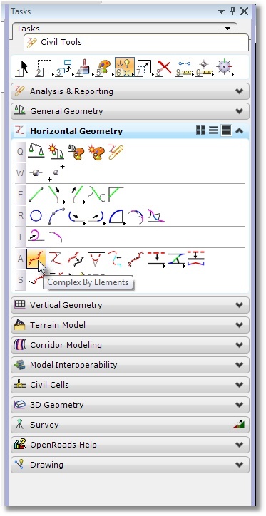

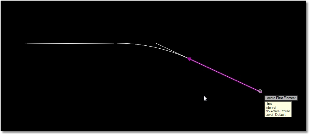

To reverse this direction, follow the steps below:
The resulting alignment will be stationed in the desired direction (in this case, east to west).
