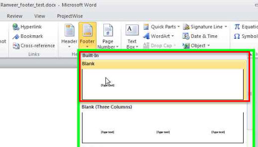

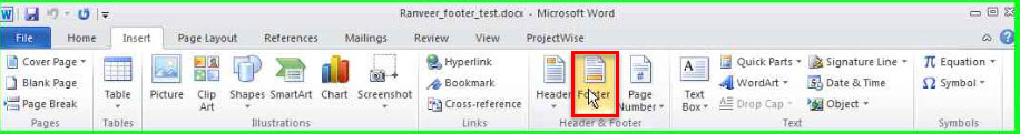

1. In Word ; To add the coding to display the ProjectWise path and document file name, open the footer: (sc1) and (sc2)
sc1
sc2

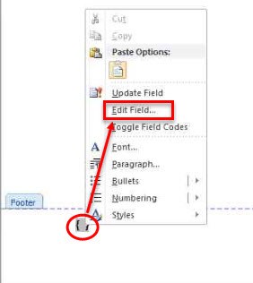

2. click CTRL – F9 in between the { } right click and select Edit Filed.... (sc3)
sc3

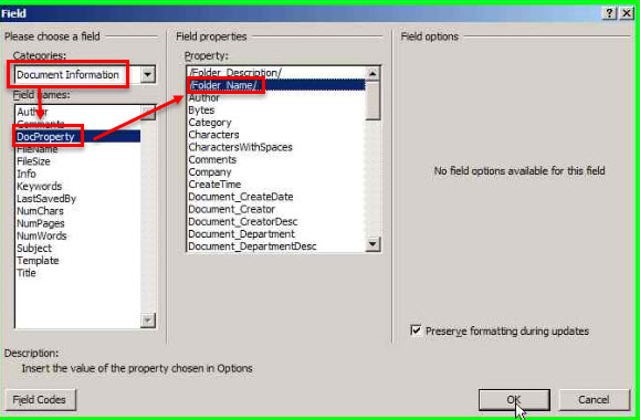

3. In the Catergories dropdown: select document Information and select DocProperties then select /Folder Name/ (sc4)
sc4
4. This will add the folder path (sc5)
sc5
