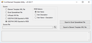

Converting the SMD to Element Templates
- 1. Double-click on the Civil_Elementtemplate_Utility.exe file. This executable is in a different Migration Utilities folder. This executable is typically located here:
- C:\ProgramData\Bentley\OpenRoads Designer CE\Configuration\Organization-Civil\Migration Utilities
- 2. Toggle on the GEOPAK SMD Exported to MDB Toggle
- 3. Select the MDB Options
- a. Item Name – Uses the SMD item Name for the Element Template Names
- b. Item Description - Uses the SMD item Description for the Element Template Names
- c. Item Name + Description - Uses the SMD item Name & Description for the Element Template Names (This is the preferred option which will yield the best results)
IMPORTANT ** Select the Option before you load the MDB
- 4. Pick the magnifying glass to select and load the MDB file
- 5. Pick “Export to Excel Spreadsheet File” to review and modify your Element Templates or select “Export to Element Template XML File” to create a file to load into OpenRoads Designer

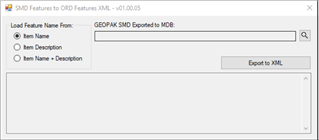

Converting the SMD to Feature Symbologies and Feature Definitions
- 1. Double-click on the SMDfeatures_to_ORDfeatures.exe file
- 2. Toggle on the Load Feature Name from Option a. Item Name – Uses the SMD item Name for the Feature Symbology & Feature Definition Names
- b. Item Description - Uses the SMD item Description for the Feature Symbology & Feature Definition Names
- c. Item Name + Description - Uses the SMD item Name & Description for the Feature Symbology & Feature Definition Names
- IMPORTANT **Select the Option before you load the MDB
- IMPORTANT **Use the same option used for the Element Templates
- 3. Pick the magnifying glass to select and load the MDB file
- 4. Pick the “Export to XML” button to create the Feature Symbology & Feature Definition XML files to be imported into OpenRoads Designer
Note: This will create 2 xml files.
