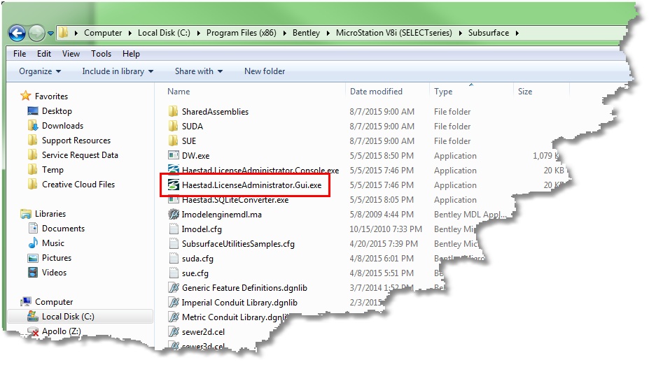

Answer 2 - SELECTserver licensing:
In the Subsurface folder under the product install directory, start the program named Haestad.LicenseAdministrator.Gui.exe.

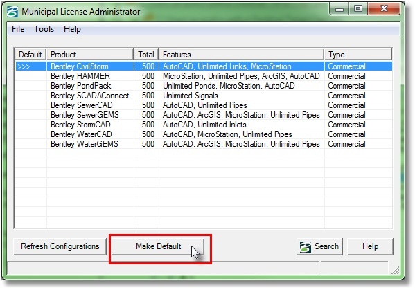

For each of the advanced hydraulic products, highlight the license level to be used, then select "Make Default".
Setting the correct feature level in the Municipal License Administrator
