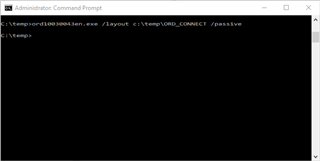

  3. Open Admin command prompt and navigate to where the “ord10030043en.exe” resides (in our example to “C:\temp”) and run the command as shown:
 C:\temp>ord10030043en.exe /layout c:\temp\ORD_CONNECT /passive
 4. This will start the download of all the installation files to the “ORD_CONNECT” folder

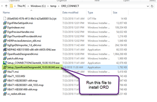

 5. After all files are downloaded, run “Setup_OpenRoadsDesignerx64_10.03.00.043.exe” to install ORD:
