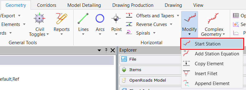

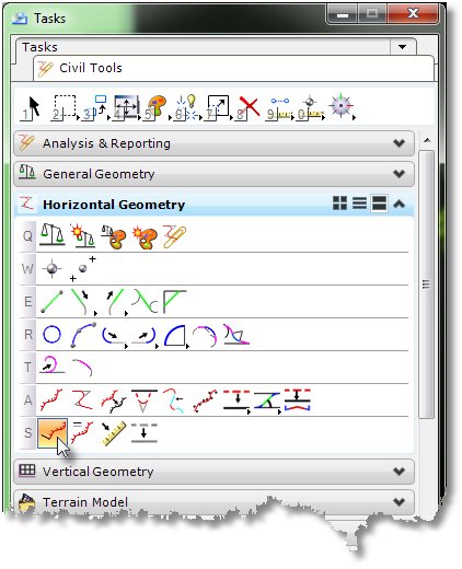

How do I define the start station for horizontal geometry?
Answer:
The Start Station command in Geometry > Horizontal > Modify > Start Station assigns stationing to an element. The command allows you to assign a station value and a position along the element for that station value. This command can be used on a civil element or a plain Drawing graphic. If this command is never run, then the beginning stationing is assumed to be zero.
