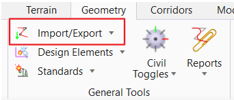

1.  Click Geometry > General Tools > Import/Export

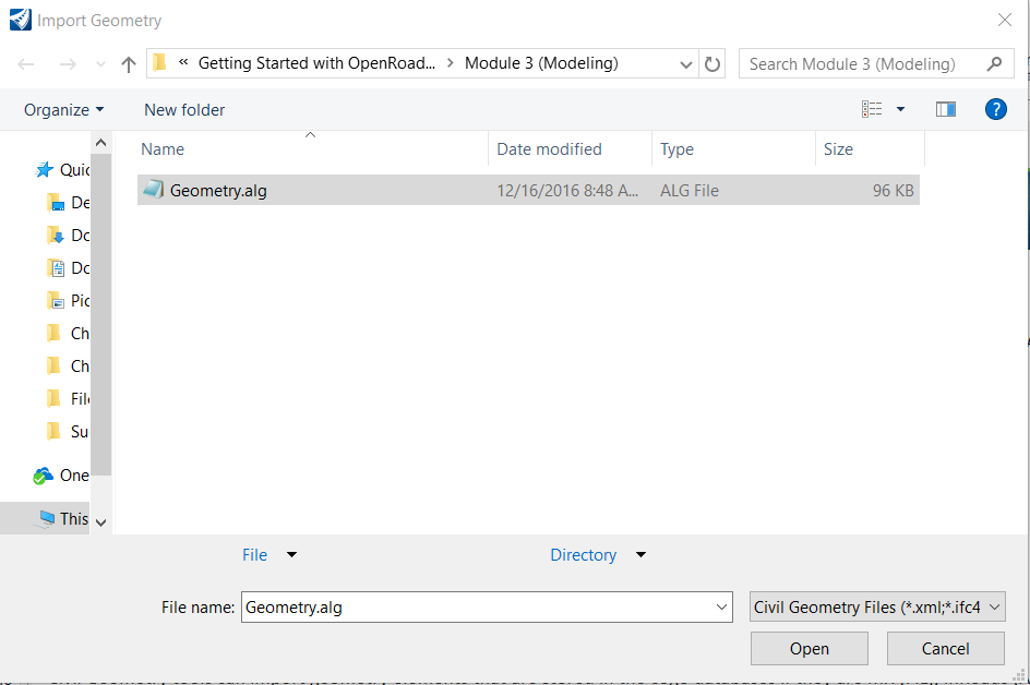

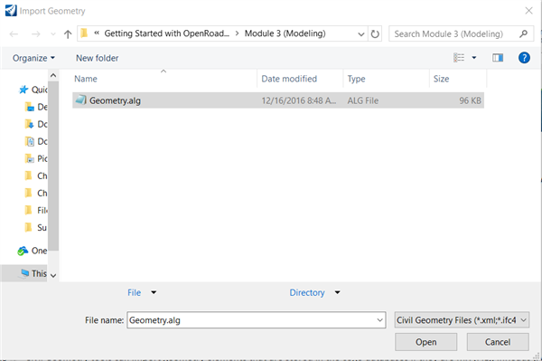

2.  Navigate to the file and click Open.

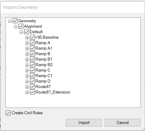

3.  Check the alignments you want to Import. If you want to import all, check the file name. Check Create Civil Rules to create ruled civil elements from the geometry file. Click Import. Do a Fit View to verify that the alignments are imported into the model.
