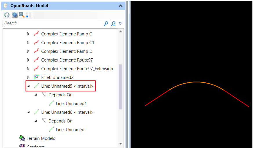

How do I remove intervals from civil geometry elements?
Answer:

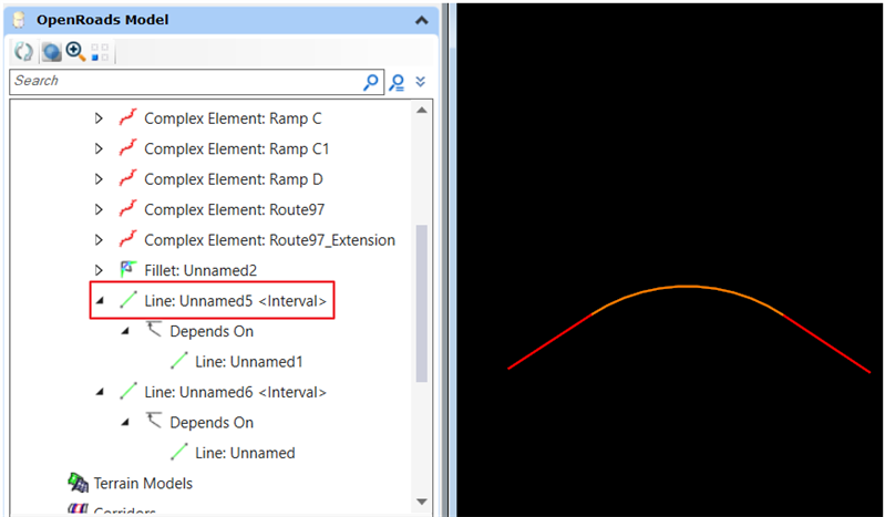

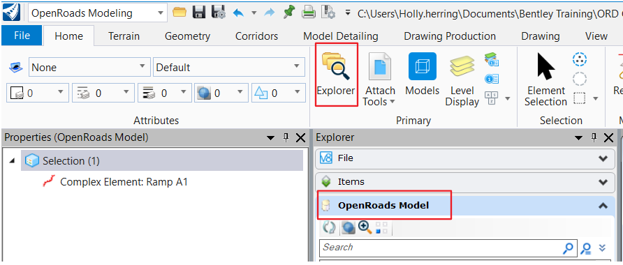

Locate the civil geometry element in Home > Primary > Explorer > OpenRoads Model. There you will see the intervals, with the original element name as a child of the interval.

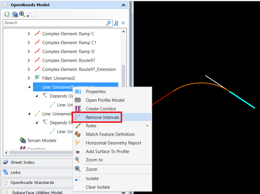

Highlight the name of the interval geometry element, right-click to display the pop-up menu, and select Remove Intervals.
