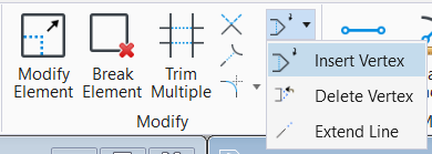

How do you insert a PI into horizontal/vertical geometry in OpenRoads Designer?
Answer:
Use the Insert Vertex command found through Drawing > Modify > Inset Vertex.
