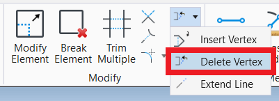

How do you delete a PI (horizontal or vertical) in OpenRoads Designer?
Answer:
Go to the Drawing tab > Modify > Delete Vertex command, and identify the element to remove the PI.
