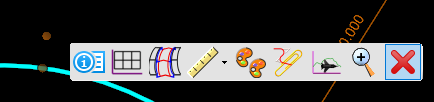

2.  Using the Element Selection tool, select the graphic element for the geometry and hover on the element to display the Context Tool Box. Select the option to 'Delete' to delete the element from the Design File.

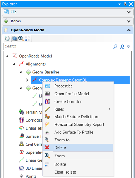

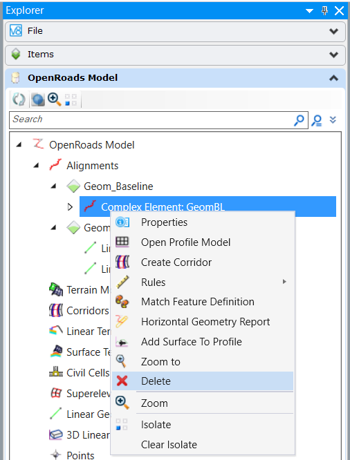

3.  Go to Home > Primary > Project Explorer > OpenRoads Model > Alignment and expand the Feature Definition containing the alignment. Right-click on the alignment's name in the Project Explorer and 'Delete'.
