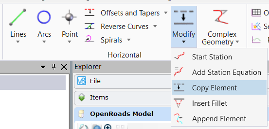

How do I create a copy of civil geometry?
Answer:
You will need to use the command Copy Element located at Geometry > Horizontal > Modify > Copy Element.
This will create a new geometry with the following properties:
If you toggle on "Do not copy rules", a new instance of geometry will be created with the following properties:
Note:  The Drawing > Manipulate > Copy command will create an element that is not ruled, not featurized, not named, and not true civil geometry.
