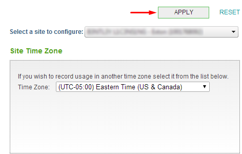

  7. Finally, click the Apply button in the upper right corner to save changes.

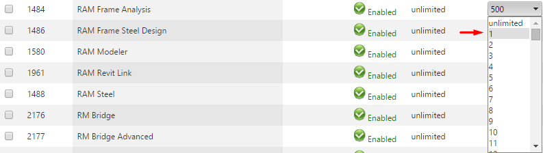

Bentley's SELECT Open Access program provides unlimited access to the majority of Bentley's portfolio, much like the Enterprise License Subscription often used by large organizations. Because license access is unlimited, however, all products show with a quantity of 500, breaking step 2 in the suggested workflow above. To compensate, SELECTserver's Checkout Restrictions feature can be used to specify license quantities available for checkout. Please perform the following steps:

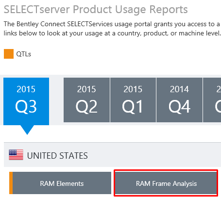

  1. Open the SELECT Open Access portal.

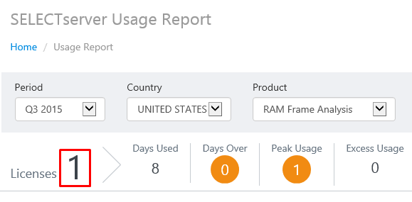

  2. Click on a product to view the number of licenses owned.
  3. On the screen that appears, note the number of licenses. This is the number of licenses owned.
  4. Visit the SELECTserver administration site.

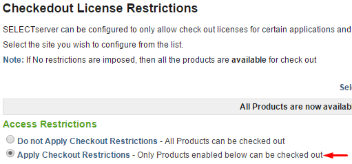

  5. Select Checkout Restrictions from the Site Configuration drop-down menu along the top edge.
  6. Enable Access Restrictions if they are not enabled already.
  7. Find the product of interest in the list below. Note that it will likely be on another page. Use the page navigation controls at the bottom as needed. To limit the list of products to only the ones you own or want to lease on a quarterly basis, consider using a Custom Activation Group.
  8. Once the product has been found, pull down the Restrictions drop-down menu, and choose the quantity of licenses owned as determined in step 3.
Once the license quantities have been adjusted to owned quantities using the steps above, the suggested workflow above will work as expected.
