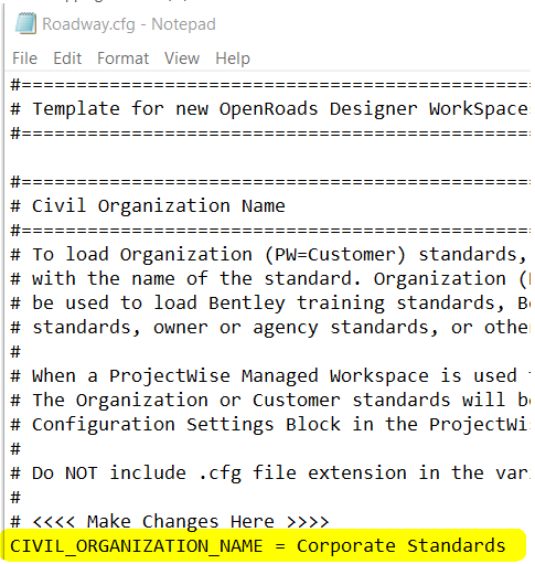

- Open the new WorkSpace cfg file (DOT Standards.cfg)
- Add a line defining CIVIL_ORGANIZATION_NAME as the Organization Level name
- Save and close

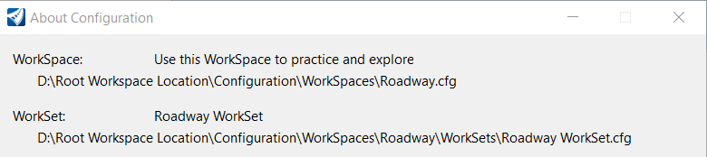

- Open OpenRoads Designer to see how it loads the Organizational level and allows the user to choose a specific Workspace and create/choose a WorkSet.
- Under File > Settings > Configuration > About Configuration it will show where the WorkSpace and WorkSet are pointing
