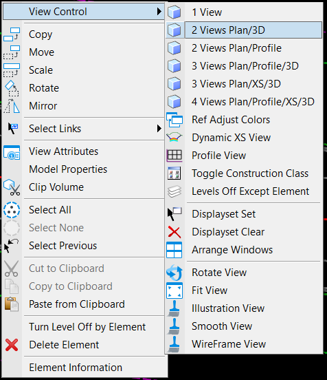

Can I open a View window that will display the location of my active 2D view in 3D?
Product(s):OpenRoads Designer
Version(s):10.00.00.120+
Area: Corridors
Original Author:Holly Herring, Bentley Technical Support Group
Question:
Can I open a view window that will display the location of my active 2D view in 3D?
Answer:
Within the 2D view, do a Right-Click and Hold, click View Control > Views Plan/3D to quickly open a 3D view window that zooms to the location of the active 2D view window.
Also, check out the other View Control options available that allow opening dynamic cross-section views, profiles views, and combinations in a quick, user friendly way.
