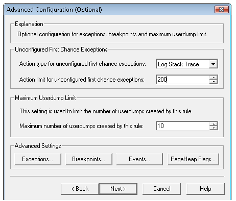

07. Advanced Configuration (Optional)->Action type for unconfigured first chance exceptions->Log Stack Trace->Action limit->200
NOTE: You can skip the option for “breakpoints” and “page heap” for now
08. In the Advanced Configuration (Optional)->click Next
