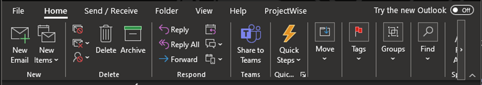

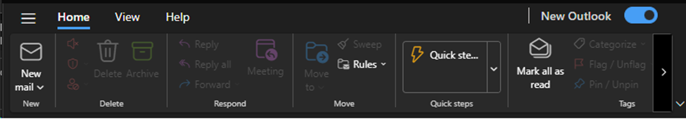

ProjectWise integration has stopped working for Outlook when user changed interface to New Outlook.
Trouble shooting steps:
New Outlook has been released as a substitute for Windows Mail and Calendar and does not support COM Add-ins as stated in this Microsoft Article: Add-ins in the new Outlook for Windows - Microsoft Community Hub.
The integration of ProjectWise with Microsoft relies on COM add-ins to provide functionality between the software. With this unilateral decision, Bentley does not support integration between ProjectWise and New Outlook.
 Please continue using the previous version of Outlook 365 that supports COM Add-ins.
