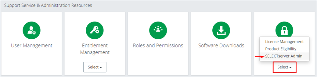

Important: For users of SELECTserver OnLine, Bentley's licensing solution over the Internet, a Bentley login with the Site Administrator role is required to complete the steps below.

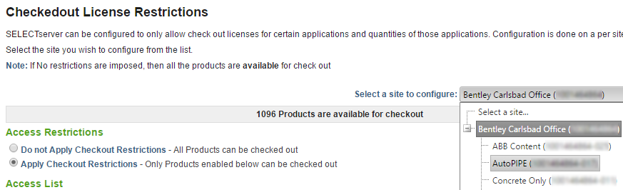

Locate the navigation bar along the top, and select Checkout Restrictions from the Site Configuration drop-down menu.
Select the radio button labeled "Apply Checkout Restrictions" if not already selected. This will enable the product list immediately below it.
Select specific products in order to enable or disable checkouts by selecting the checkboxes on the left, and then choosing Enable/Disable from the drop-down menu just above the list.
The value in the Status column will change from Enabled to Disabled.
If a product has checkouts disabled, the Checkout Restrictions will simply prevent licenses from being checked out via the Product Activation Wizard or License Management Tool. Most products will still activate and log usage as before with the exception below.
