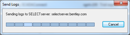

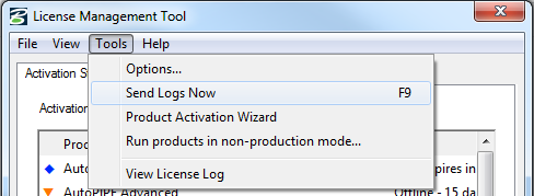

Fortunately, workstations can send any recorded usage to SELECTserver in one of the following ways:
Bentley provides a utility with a graphical user interface for the configuration of license settings. To use tool to send usage, perform the following steps:
The Send Logs Now command covered in the previous option is performed in the background by a utility called Bentley.lictransmit.exe. It is also included with Bentley products alongside the License Management Tool. Bentley.lictransmit.exe can be executed directly from a command line to send logs. One can also use the Task Scheduler in Windows to run the utility once a day to ensure timely reporting of usage data regardless of how often Bentley products are used. The following Microsoft technical note provides instructions for scheduling a task.
