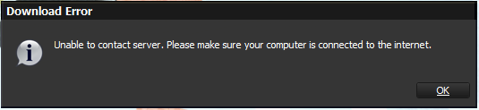

When accessing LumenRT through the ConceptStation Visualization option, we are unable to place animation objects (i.e. people, animals, trees, cars etc.) It yields an error message: "Unable to contact server. Please make sure you computer is connected to the internet."
Answer:
This error occurs in both LumenRT and ConceptStation as the link to the content server is broken. (***Note: The e-on software content site is currently down but is expected to be fixed within the next month.***) Therefore we need to manually install the LumenRT Content from the Bentley Software Downloads and place it in the corresponding program directory for the program to read. To do this:

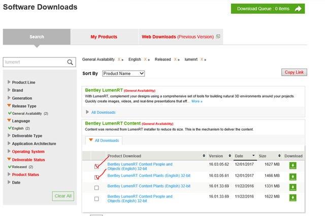

Download LumenRT Content
- Go to the downloads page through the Connection Client or go to connect.bentley.com and search the downloads for "LumenRT".
- After you search, make sure you disable the CONNECT filter, so the results can display all LumenRT Content.
- Download the Bentley LumenRT Content People and Object (version 16.03.05.62) as well as the Bentley LumenRT Content Plants (version 16.03.05.61).
- Once downloaded, if you have LumenRT Update 3 standalone installed, you should go to C:\ProgramData\e-onsoftware\LumenRT 2016\LumenRT Content and delete the content from that folder prior to running the executables.
- Run the lumenrtcontent16030561en.exe and lumenrtcontent16030562en.exe to install the Content.
