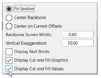

Question:
How to display cut and fill graphics and values in dynamic cross section model ?
Answer:
Click on the view properties pull-down.
Enable "Display cut and fill graphics" & "Display cut and fill values"
