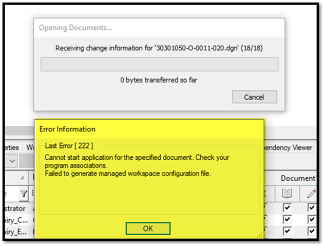

Design files, with Managed Workspace association, were failing to open from ProjectWise Explorer. The following error message is displayed,
Last Error [222]
Cannot start application for the specified document. Check your program associations.
Failed to generate managed workspace configuration file.
On removing the Managed Workspace associations from the file, the file opens perfectly.

2023-09-25 16:15:58,083 ERROR [0x000057f8] pwise.dms - Error 222 "Cannot start application for the specified document. Check your program associations. Failed to generate managed workspace configuration file."
The above ERROR lines in the pwc.log indicates that the variable of MS_PLTFILES is defined incorrectly in one of the CFG files or ProjectWise CSBs. As a result, the configuration file fails to generate for the design files.
The pwc.log file indicates the format of the statement is '$(dms_project (_DGNDIR)\' which is incorrect.

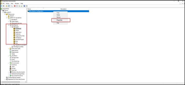

Finding the variable in the ProjectWise CSB's
To find out whether the variable is defined incorrectly in any of the ProjectWise CSBs & correct it, please follow the steps given below:

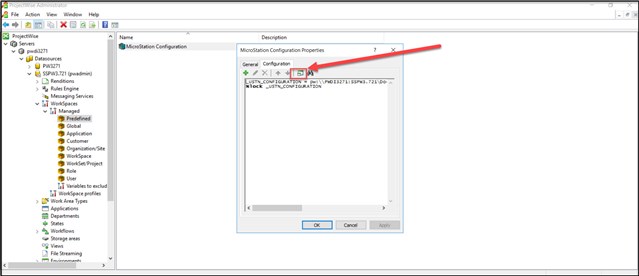

  1. In ProjectWise Administrator tool, browse to Workspaces> Managed. Right click on the first CSB that is defined under Predefined level & go to Properties.
  2. In the Properties dialog box, go to the Configuration tab. Use the button shown below to float the Configuration Variables window.
    Correct the format of the configuration variable of MS_PLTFILES, if it exists in this CSB.
Repeat the process for all the CSBs in all the levels namely,
Predefined, Global, Application, Customer, Organization/Site, Workspace, Workset/Project, Role, User

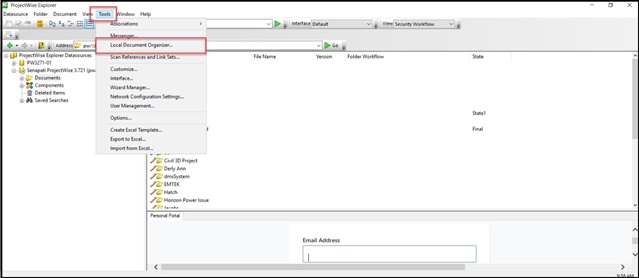

  1. In ProjectWise Explorer, follow the steps given below to purge the local working directory:
    1. Click on Tools menu & select 'Local Document Organizer...'

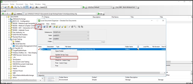

    2. Look into the 'Checked Out Documents' tab and check in any files observed in this tab

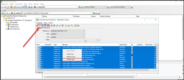

    3. Look into the 'Copies', 'Workspace Copies' and 'Exports' tab. If any items are observed in any of these tabs, select all of them in bulk, right click and select 'Purge Copy'. This will purge all files from the local working directory.
  2. Delete all the folders inside the local working directory, including the 'Workspaces' folder.
