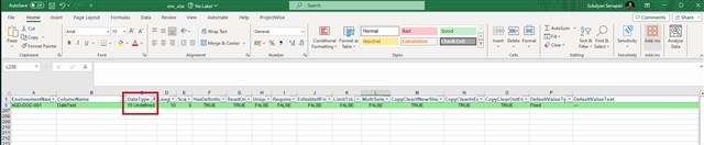

Further investigations revealed that the root cause of the issue was an attribute with incorrect Data Type.
This attribute had a suspicious Data Type of ’15 Undefined’ as shown in the screenshot below. Generally, it is text, int or datetime. The Data Type of attributes can be observed in the database (for on premise ProjectWise server) or, extracted with the PowerShell command-let of Export-PWEnvironments (for ProjectWise servers hosted by Bentley).
The attribute was deleted, and this fixed the issue.

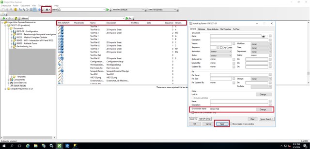

Before proceeding to delete an attribute, it should be checked if the attribute contains any data. Following two ways can be used to check if any attribute contains data from before:
To check if an attribute (say, attr) in an environment (say, envSample) contains any data, the following SQL query can be run in the ProjectWise database:
SELECT attr FROM envSample
ProjectWise Document Search can also be used to check if the attribute contains any data. Documents belonging to the environment can be searched using the Document Search tool by following the steps given in the link below:
https://docs.bentley.com/LiveContent/web/ProjectWise%20Explorer%20Help-v12/en/GUID-BAEA3B35-0C06-6765-8FCE-817741410F3B.html

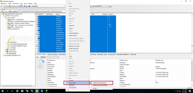

Once the environment is selected on the ‘Search by Form’ dialog box, click on Apply to list the documents. The attribute needs to be added as a column to the view.
The result of the search will help to understand if the required attribute contains any data inside it. The search results can be selected, copied to clipboard (tab separated) and pasted to an Excel spreadsheet as shown in the screenshot below.
If the attribute contains data, it might need to be copied to a new attribute.
