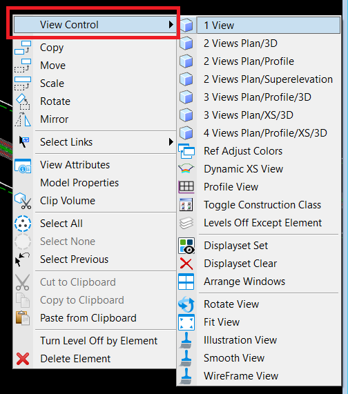

Question:
How do I display the "View Control" when doing a long right click? I don't have it on the menu.
Answer:
The View Control uses a custom macro that must be part of your active workspace. In the default installation, the ViewSet macro is located at C:\ProgramData\Bentley\OpenRoads Designer CE\Configuration\Organization-Civil\_Civil Default Standards - Imperial\Macros\ViewSet.mvba. You can copy that to your workspace and set the MS_VBAAUTOLOADPROJECTS configuration variable to load it automatically.
