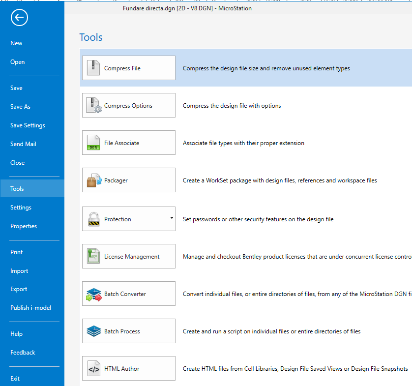

How do I open the License Manager in the MicroStation CONNECT Edition for versions without SES?
There are 3 options to access the License Management tool:
  1. The License Manager opens in MicroStation CONNECT Edition via the backstage: File > Tools > License Management …
  2. Upt to Windows 7, via Windows Start > Program Files > Bentley > SELECTserver > Bentley License Management
  3. Search the computer for the file licensetool.exe and start it
