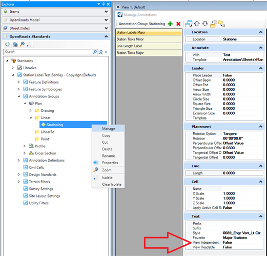

How can I configure station label text to rotate with the referenced design file in my drawing model?
In my Annotation Group the Major Stationing labels are set to Tangent, but when I rotate the reference file in the Drawing model, they stay in the same rotation as originally placed.
Answer:
Change the "View Independent" text setting to false in the annotation group settings. A view independent text element displays at the same orientation regardless of the rotation of the view.
