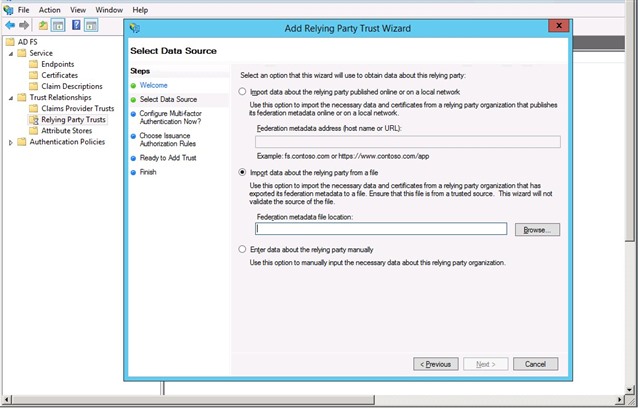

4. In the Select Data Source screen, select the second option “Import data about the relying party from a file”.
5. Click Browse, select the FederationMetadata.xml you saved from step 1, and click Next.

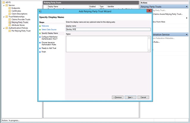

6.  On the next screen, enter a name in the Display name field and click Next.
Enter Bentley IMS for the production environment

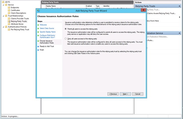

8. On the next screen, select the “Permit all users to access this relying party” radio button and click Next.

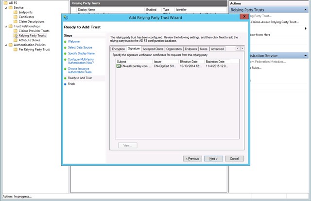

9. On the next screen, verify the Signature details shown are valid. Click Next.

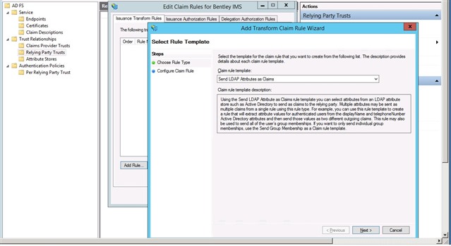

1. On the Edit Claim Rules page, click Add Rule.
2. Select the claim rule template Send LDAP Attributes as Claims from the dropdown and click Next.

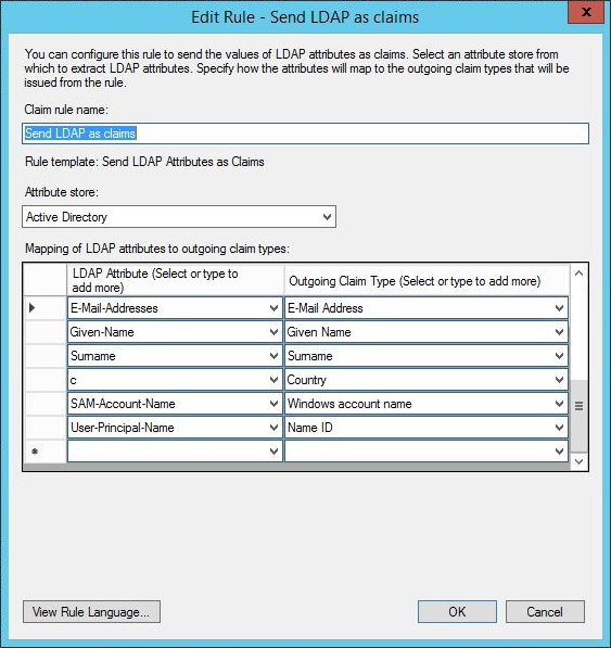

3. Select the attribute store Active Directory. Select the following LDAP Attributes and outgoing claims using the screenshot below as a reference.
Claims rules setup
Notes:
#1 – The Country attribute is typically stored in the LDAP database under an attribute named “c”, however in your tenant it may be stored elsewhere, so verify the location of the country information for your tenant. If "c" is not in the drop-down list, and that is where your country information is stored, you must manually type “c” into the blank attribute box.  Regardless of where it is stored in LDAP, the outgoing claim should be called “Country”.
#2 – If you define “c” as the country attribute, you will also need to define the correct schema for the “c” attribute in the Claim Descriptions as seen below or it could cause the federation to fail:
http://schemas.xmlsoap.org/ws/2005/05/identity/claims/country
#3 – You should send the e-mail attribute if you are using the email address as the unique identifier for your users, but use the UPN attribute and value instead if your users are identified by their UPN. The UPN claim syntax is as follows:
LDAP Attributes
Outgoing Claim Type
User-Principal-Name
UPN
#4 – We suggest using e-mail address as the primary identifier, but if you need to use the UPN, do not send the email address attribute as well.  Either the "UPN" or the "E-mail Address" claim should be sent - not both.
#5 – After chosing to send either the "E-mail Address" or "UPN" claim, always send the NameID claim with the UPN. The NameID field is required regardless.

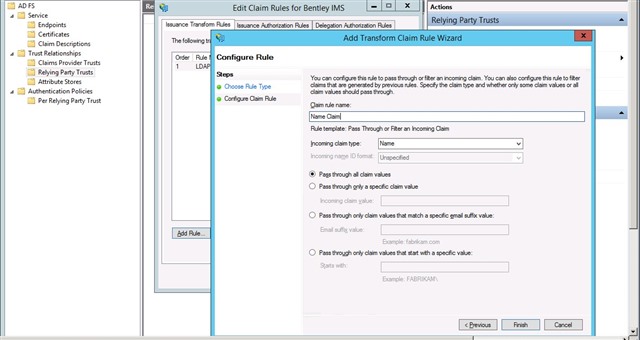

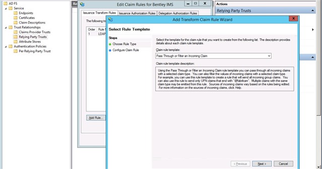

5. Using the Edit Claim Rules wizard, click Add Rule again.
6. Select Pass Through or Filter an Incoming Claim and click Next.
7. Enter Name Claim as the rule name. Select Name as Incoming claim type and choose Pass through all claim values. Click Finish.
8. Click OK to close the Edit Claim Rues dialog.

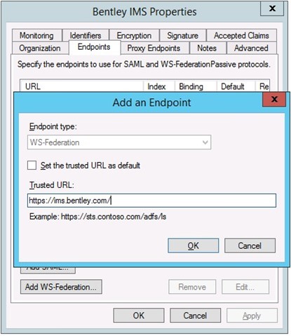

3. Click on Add WS-Federation.
4. Type in the endpoint in the Trusted URL field. Make sure to check Set the trusted URL as default. Click OK.
Enter https://ims.bentley.com/ for the production environment (must include the trailing slash)

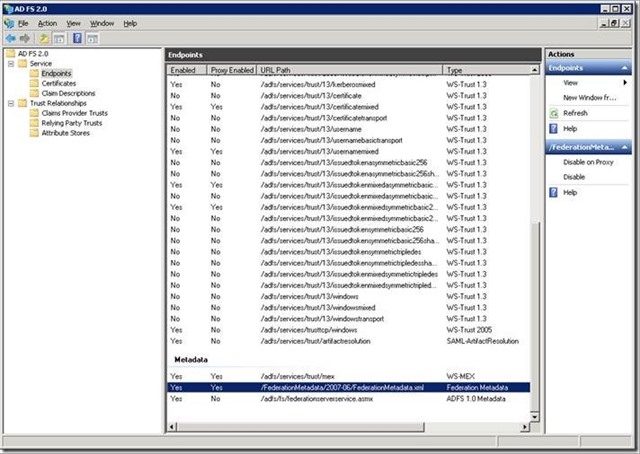

Your organization's Federation Metadata URL is available in the AD FS Management Console.
Browse to Service > Endpoints > Metadata > Type:Federation Metadata to find your federation metadata URL.
You will need to provide your organization's Federation Metadata URL to Bentley.  Once the Federation Metadata URL is provided, Bentley will configure your organization for federated identity in Bentley's Identity Management System.
