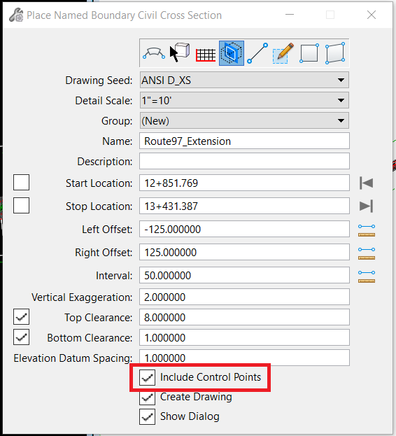

How do you automatically cut sections in locations such as the PC, PT, critical points, etc.?
Product(s):OpenRoads Designer
Version(s):10.04.00.48+
Area: Drawing Production
Original Author:Holly Herring, Bentley Technical Support Group
Question:
Answer:
When you use the Place Named Boundary, make sure that Include Control Points is checked.
