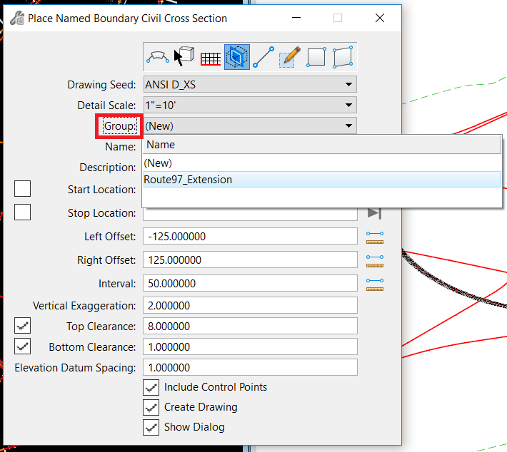

How do I set different widths for the boundaries of the cross sections?
Product(s):OpenRoads Designer
Version(s):10.04.00.48+
Area: Drawing Production
Original Author:Holly Herring, Bentley Technical Support Group
Question:
Answer:
Layout each specific boundary one by one from the Place Named Boundary tool. Be sure to select to place each of these Named Boundary into the same Group. Create your sheets once you have all the widths you'd like.
