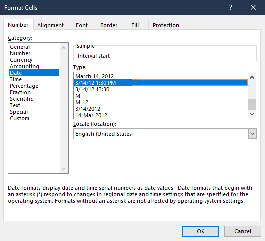

  1. Select Columns S and T.
  2. Right-click on them, and select "Format Cells..." from the contextual menu.
  3. In the dialog that appears, select Date from the Category list on the left side.
  4. In the Type list on the right side scroll down, and select the listing with both a date and time stamp in either the 12-hour or 24-hour format.
    Screenshot of Format Cells dialog
  5. Click OK to save changes.
