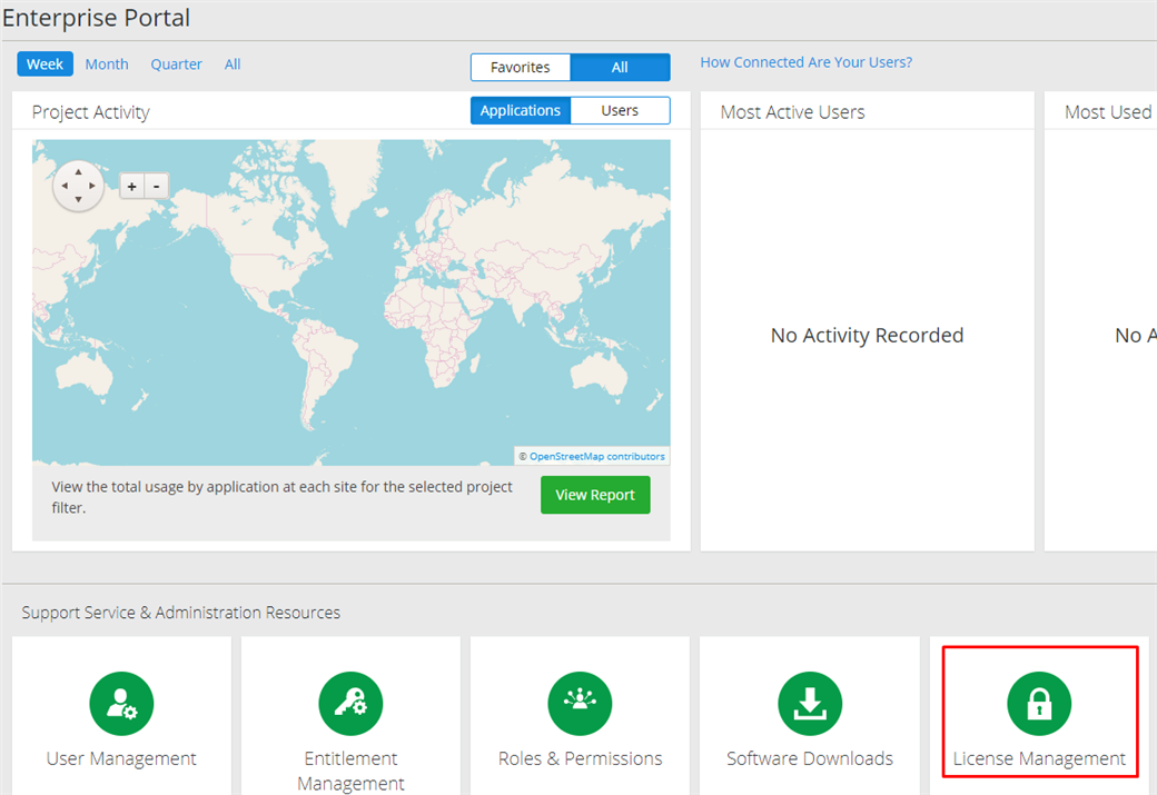

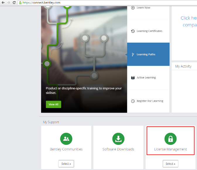

Where is the License Tool located?
The License Tool can be accessed from the Enterprise Portal by clicking on the License Management tile in the Support Service & Administration Resources section.
