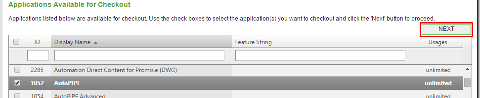

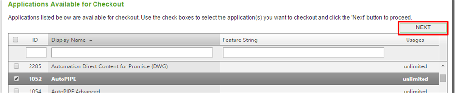

From the Navigation Bar, go to License Management. Depending on the version of SELECTserver, click on either "License Checkout" or "Checkout A License."
Select the desired application from the products listed and click the Next button.  If there are no products listed, they may need to be made available for checkout under "Checkout Restrictions."

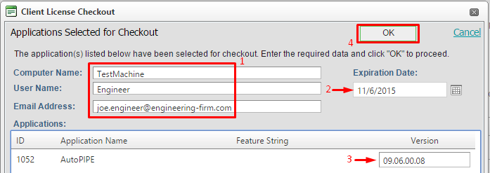

Enter the necessary information:
Note: It is important to enter the correct version number of the product being checked out.
Some versions of the License Management Tool require that you enter 3 digits for each field of the version number instead of 2. If you cannot proceed to the next step of the product activation, try adding a leading zero to the values in the version boxes (for instance, 08 becomes 008).
The version number can be found by opening the product, clicking the Help menu and selecting "About <Product>".
Click Ok.
