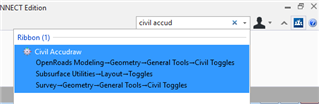

You can use the Civil AccuDraw and the Analyze Point tool to achieve this:
  1. Launch the Civil AccuDraw
  2. Toggle Civil Accudraw
  3. Select the Station-Offset option

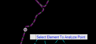

  4. Launch the Analyze Point Command
  5. Select the Terrain Model you want to have the Elevation
  6. Specify the Station and Offset in the Civil AccuDraw window
