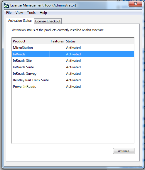

  2. In the Bentley License Tool on the Activation Status tab highlight the product you wish to activate and select Activate

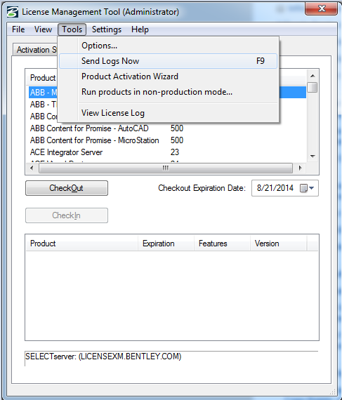

  3. In the License Management Tool, select Tools > Send Logs Now

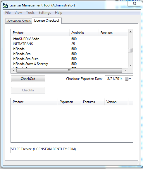

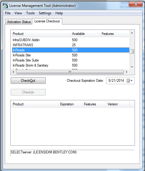

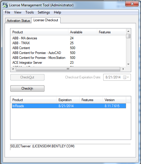

  5. If this is not successful, on the License Checkout tab of the Bentley License Tool, locate the product you are unable to activate.  Highlight the product and click CheckOut.  Enter your email address and select OK.  You should get a Results box with the status as "Success".  Select Close
  6. Again on the License Checkout tab, highlight the checked out product in the bottom pane.  Select CheckIn.
